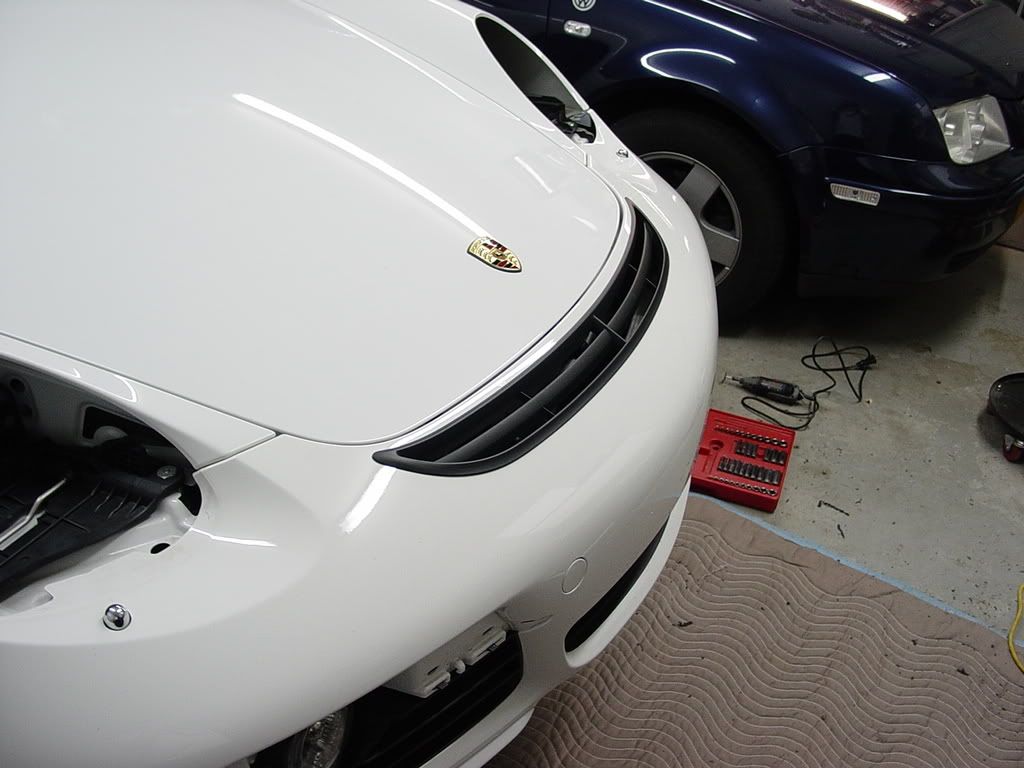

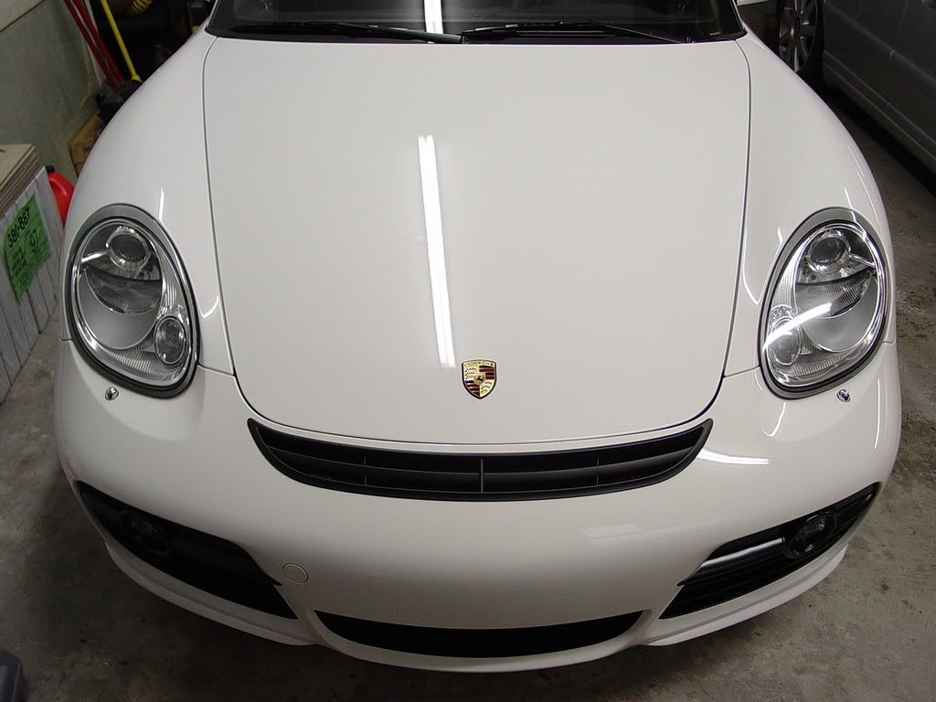

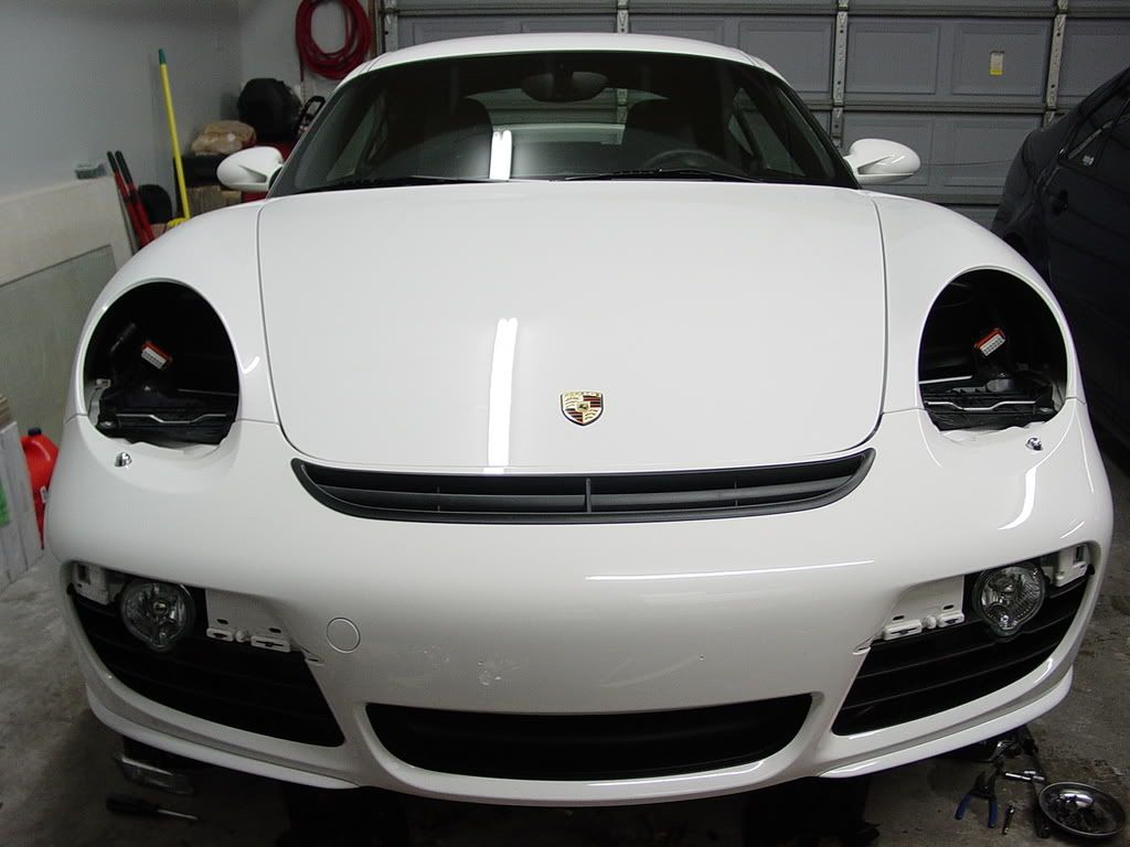

Just finished the GT3 frill install, only thing is all of the pics I took somehow got damaged. All of the install pics my disc went bad I would have to take everything off and take the pics again. I actually cant take the GT3 grill off because It has epoxy holding it on. -tip FarnbacherLoles gave me, thanks guys
[IMG][/IMG]

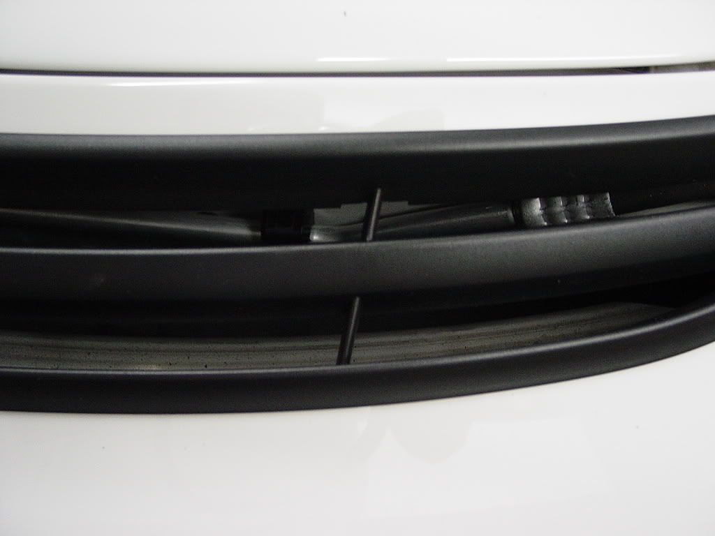

I moved the Homelink sensor closer to the body so It would not be so exposed to the elements. I didnt have to but just felt It would get too wet. Its sealed pretty good.
[IMG][/IMG]
you cant really see it because I moved it so far back. doesnt effect the range of the sensor.
[IMG][/IMG]

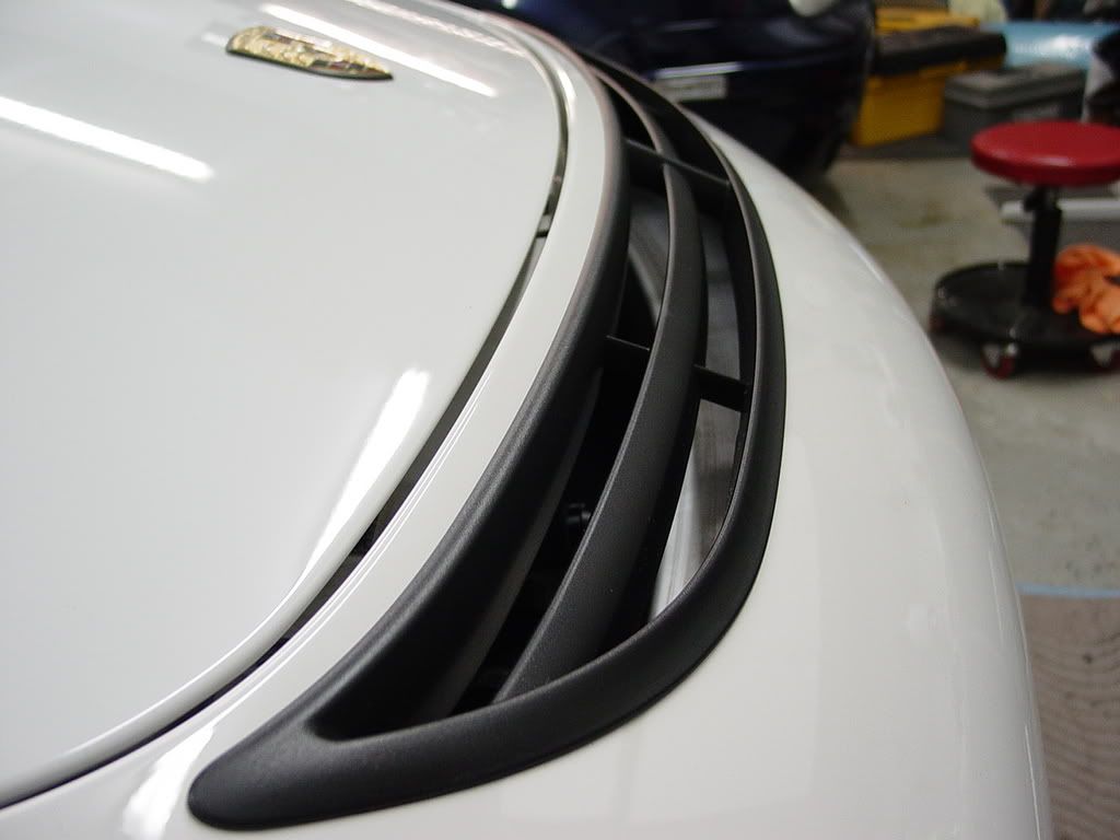

I mounted the Grill perfect on both sides (even) I didnt realize even the Carerra GT uses the exact same part. -wife drives the jetta-
[IMG][/IMG]
I will be doing an article on this, guess I will take it all apart tomorrow
Special thanks to Jason at TischerPorsche for such a good price on the grill $24.85! Article coming soon...
**FOR THOSE OF YOU LOOKING TO DO THIS MOD YOU NEED TO BE BRAVE-CUTTING THE BUMPER WITH A DREMEL REQUIRES A STEADY HAND!! ALSO YOU BETTER HURRY AND ORDER YOUR GRILL SOON AVERAGE COST IS $48.00 PORSCHE WILL BE RAISING THE PRICE SOON I ASSUME. THE SAME THING HAPPENED WITH MERCERDES WHEN THEY WERE SELLING THE AMG 4 PISTON CALIPERS FOR $250.00 A SET! THEY REALIZED IT WAS AN ERROR NOW THEY ARE $800.00 A SET. (my brother is a benz guy)

Thanks! Oh yeah I also cut hole one inch wide all along the top of the bottom cup so the air flows up and out the grill

I actually also used some plastic clips so you cannot pull it off without taking out the bumper. Also the cut out was smaller so you have to flex out the top of the bumper to get it out too.
