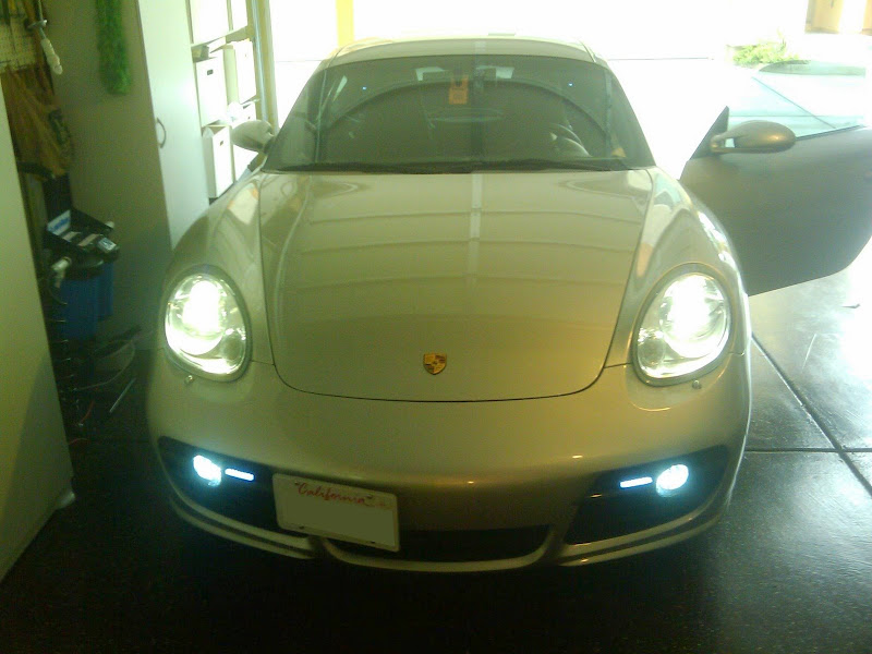

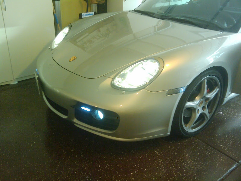

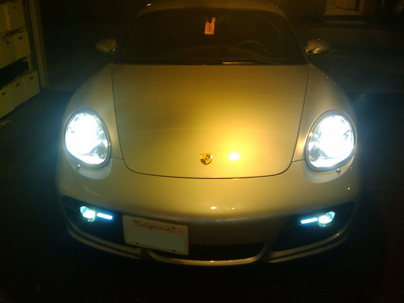

09 DRL LED DIY finally installed
Acronyms rock!
I had some time on my hands so I finally installed my DRL LEDS's on my 08 CCS. I was inspired a while back by the DRL DIY article I saw here but I was looking for a bulb set closer to the 09 (lengthwise) and I finally found one.
Anyway, no cuts. 3 screws and a splice and 2 hours total. I'll post a DIY soon but here are pics in the meantime..
FYI, no bulb out problems, I spliced off the driving light wires, and I bought the bulb from ijdmtoy.com. The lights are flush with the fog spears and I had to make zero cuts to anything. just drilled 3 holes, 2 for the screws and 1 for the wire to power it. I did have to spraypaint the chrome set to make it black, but if you may want to keep it chrome if you want.
Enjoy!

I finally got a chance and matched my stock 4300K HIDs to the 6000K drls and Fogs
