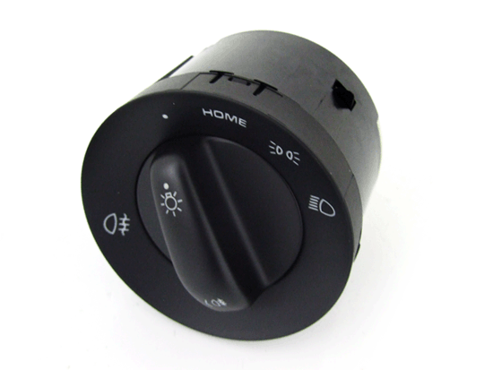

I noticed that my car does not have a way to turn on my fog lights at all outside of checking if they work via my Foxwell tool. I can't use them in any switch headlight position in normal driving though. My switch looks like this
But last weekend, I was driving my friend's also 987.2 and he has a different fog light switch that actually turns on those same round lights in the bumper. He has this one
So I tried to swap his switch into my car and it couldn't activate my own round lights in bumper. Is there a way to not only get this switch but then to also activate the fog light function? Maybe a wire needs to be added or something else to do with coding? I didn't see anything in my Foxwell OBD2 tool in the Front Control Module that would suggest being able to turn on those round lights via coding, unless I missed it.

Your photo of the front bumper is not a 987.2. That said, I'd guess that someone replaced your switch. All 987.2 Caymans came with fogs and should all have them indicated on the dash switch.

@RSchwerer What you're saying about replacing the switch doesn't make sense though because I swapped out my switch for my friend's own 987.2 with halogens.
If it was the case that mine was replaced before my ownership, then a straight putting back in the switch which does have front fog control would have woken back up my fog lights.
That doesn't make sense.

The wiring to the switch is identical on mine and my friend's 987.2 that has halogens and fogs. My Foxwell even confirmed that when I activated the front fog light function when I swapped his headlight switch assembly into my car that it saw the fog light switch activated.
So my only guess at this point is that the coding in the Front Control Module is different.
