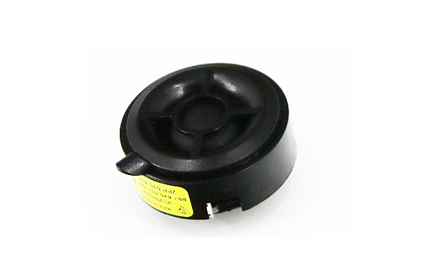

If you look at Suncoast for the replacement components, this is the stock tweeter.
Tough to read the part number, but looks like 7PP 035 4??
You can also read what looks like "997 645 021" in there.
Cross-referencing porsche parts, looks like it might be the one, but it may very well just be a stock pic of any porsche tweeter and NOT the specific one for the 987. Is this what it looks like, @foodbiker ?
Peripheral Camera accessory Gadget Audio equipment Automotive wheel system
Yes, @tiiger -- That's what in there: (997 645 021 00).
