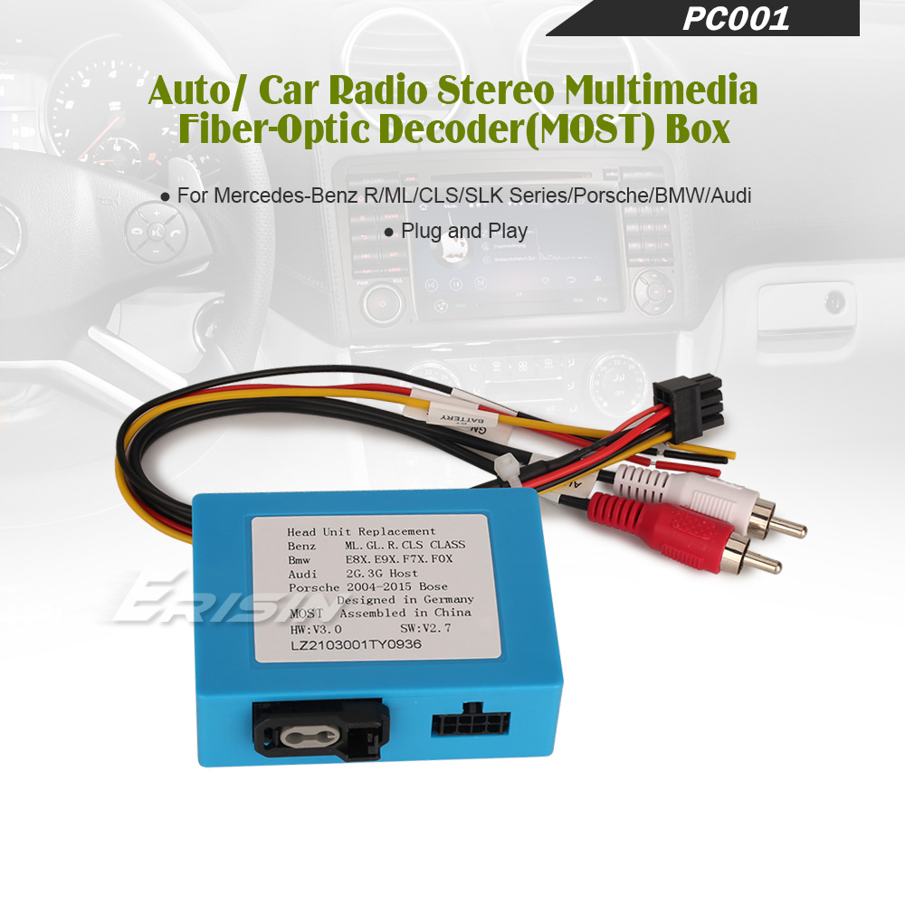

Now just need to find solution for 2014 boxster with Bose... Need optical interface that allows for 2014 models to convert for Bose speaker and amp. Anyone know this solution?
Yep, Erisin seem to have a converter box thing which might do the trick. This is a link to it on their UK store:
it does not list the 2014 however. Ugh. Does anyone know if there is a difference, if this will work indeed for a 2014 model?
thanks
I suspect the above unit will work fine with a 2014 model, it's just an optical decoder box which should be pretty standard.
