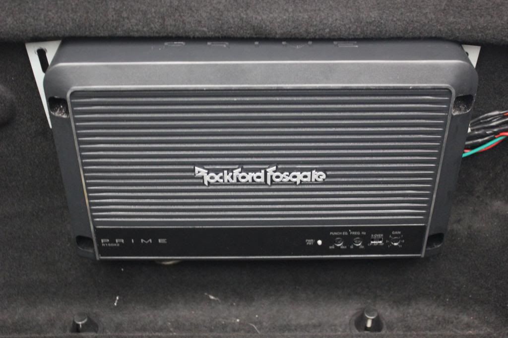

#8 ·
I went with a Rckford Fosgate Prime R150x2. Great little amp at a very good price.
I removed the inside of the panel that covers the ASK amp. the piece that contains the airinflator and oil. it is held on by 5 or 6 screws. this allowed for the amp to be mounted in the oem location using some brakets.
when you are ready to move foward PM me and i will get you all the wiring colors, etc.

#10 ·
i know exactly what amp you speak of...good little amp. although they do run rather hot due to their size so careful when you place that cover back on. i know that in my neck of the woods where average temp in the summer is 100 that would never work.
i know that from the pictures one might think that the cover was not able to fit but it does as seen from the picture below.
yes the amp is behind the cover.
