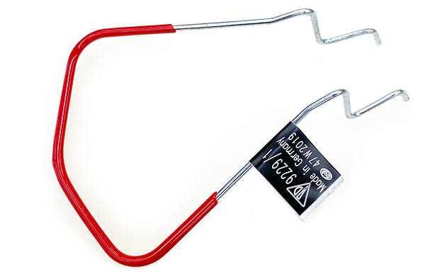

If you look closely at the center caps, you will see two small holes. You can use and angled pick to pop them off via these holes.
Porsche even sells a tool for this. But a pick or two will do the trick.

My advice? Use a toothpick far less chance of scratching
Boris - have you done this? I don't know of a toothpick strong enough to pull a center-cap off..
As fun as it would be to have another Porsche special tool (I have a drawer in my toolbox named "Special Tools" - things like this fit in there nicely and will baffle whoever is the executor of my estate someday..
Font Rectangle Auto part Cable Fashion accessory
That reallly has an unneeded right angle in it - a bit of wire from a clothes hanger might make an adequate substitute, or:
Font Office supplies Art Stationery Graphite
$9.59 or less from various vendors.

I've done it exclusively; I don't want metal on my plastic painted center caps. Now you do break a few toothpicks but that's really no concern, AND I am so practiced now I can do it without breakage. I only change the centers now each brake flush so I don't even need the toothpicks.

If you look closely at the center caps, you will see two small holes. You can use and angled pick to pop them off via these holes. Porsche even sells a tool for this. But a pick or two will do the trick.
Angled-tip small picks I have...
It's good to have an excuse to buy more Park tools for my collection of antique bikes. I spend far more time working on them than the car.

I just use an Allen Key. The small angled end goes through the hole and applies pressure from behind the cap when pulled. No damage to the front (or rear) of the cap with a bit of care.

Makes sense and everyone has those. I'm just glad it's safe to pull from the front and remove the wheels just for center caps! Well, the new caps are on the way, I should know soon.
And I realize the Park Tool SPA-2 is designed for applying force rotationally, not pulling, I doubt it would work (and I hate working on freewheels!)

I use this kind of clip to remove my centre caps. One clip per hole and pulling outwards using both hands.
Considering I am retired from a 40-year career in office products, you'd think my mind would have gone there first. :unsure: Yeah, they worked like a charm, centers are in.
