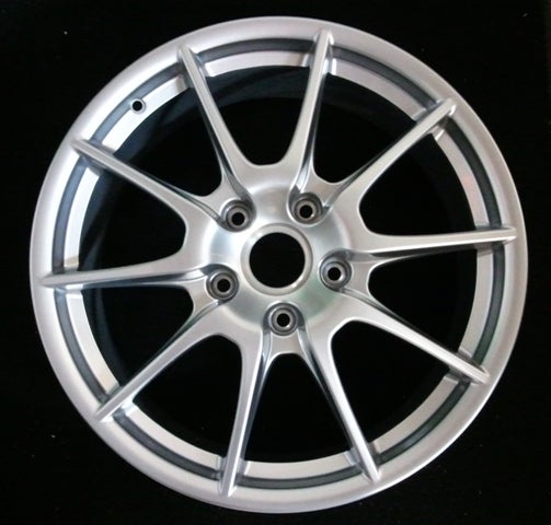

Great writeup and gorgeous car. Thanks for sharing. I like that you used CR wheels with CR suspension. It looks like the car came that way from the factory.
Thanks. I personally prefer a factory look, even if it is not necessarily how the car left the factory.

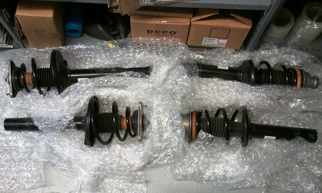

How did I miss this post ? ! Excellent, thank you. Any chance you wrote down the part # on the suspension you bought, so we can compare to the one suncoast sells and be 100% sure it's all the same #s ? I'm curious about why the ride height would be different, if only slightly... I was reading in Excellence last night that on their test they were going 31/31 on pressures on the R, I think it's safe to go lower than Porsche advertises anyway... They did the same on my 996 and boxster, the car was harsh and bouncy until you took 4 or 5 PSI out of the rear, they favor protecting wheels from potholes and safe understeer over performance. I'm very tempted to take the plunge on the R suspension, unfortunately I have recently acquired a 911T "project" whose engine is getting rebuilt as we speak, my bmw 2002 is pissing oil, therefore my fun money is fully allocated and then some ;-( In the future then!

I did not wite down the numbers, but I did compare them to what was on a CR, and they matched up.
I would highly recommend this setup, but it sounds like you have a lot of other fun projects to funnel your time/money to!
Thanks for a great post. Would you please weigh the 19" Carrera S wheels?
I'm in the process of talking with Suncoast and trying to get them to put a package together for us gen 1 people. I sent some part numbers (thanks to cman21) to them but there are also parts that cman21 could not get part numbers for but it should be simple for Suncoast to look up.
I'll keep you updated on the progress. It just started this week (9/19/11) so it still might take a little time. Hopefully they'll chime in here on their progress so I don't have to ding 'em. :)

I just wanted to update everyone on upgrading gen 1 caymans with Cayman R susp components.
After much research (and with some consideration of the poll results (http://www.planet-9.com/cayman-boxs...an-boxster-modifications/61955-cayman-r-susp-vs-bilstein-pss9-susp-upgrade.html)), I decided to go with the Bilstein PSS-9 instead of the Cayman R upgrade. At the end of the day, I like the flexibility the PSS-9s provide.
Now, with that said, I would also like to point out that between cman21 and Aldo at Suncoast, I believe Aldo has all the necessary part numbers to allow somebody to upgrade their gen1 Cayman with Cayman R components. As it turns out, the additional cost/parts are minimal (versus upgrading a gen 2 cayman).
If you're on a tight budget and you want something for daily use, the Cayman R upgrade is definitely worth looking into.
I would like to thank cman21 and Aldo for their time, patience and information.
Thanks!
-Moto

This is a summary of parts for the upgrade:
Part Numbers:
98733350900 CENTERING RING QTY. 2
98734304209 AS VIBRATION DAMPER QTY. 2
98733305118 AS VIBRATION DAMPER RA,987QTY.2
98733353196504 COIL SPRING 1 (SET)
98734353140504 COIL SPRING 1 (SET)
No Part Numbers:
Compensation plate (either 3 or 6 mm based on the color coded springs (which PWIS can tell you the correct color)) They are cheap enough where you could just order one set of each if you're unsure.
Rear strut upper mounts
Miscellaneous nuts and bolts as they are one time use parts
Brake caliper bolts need to be replaced again one time use parts
Bellows
If you need additional details, please contact Aldo at Suncoast as he has been very helpful in the matter and can provide any additional information.
Thanks cman21 for putting together what you can!
-Moto
