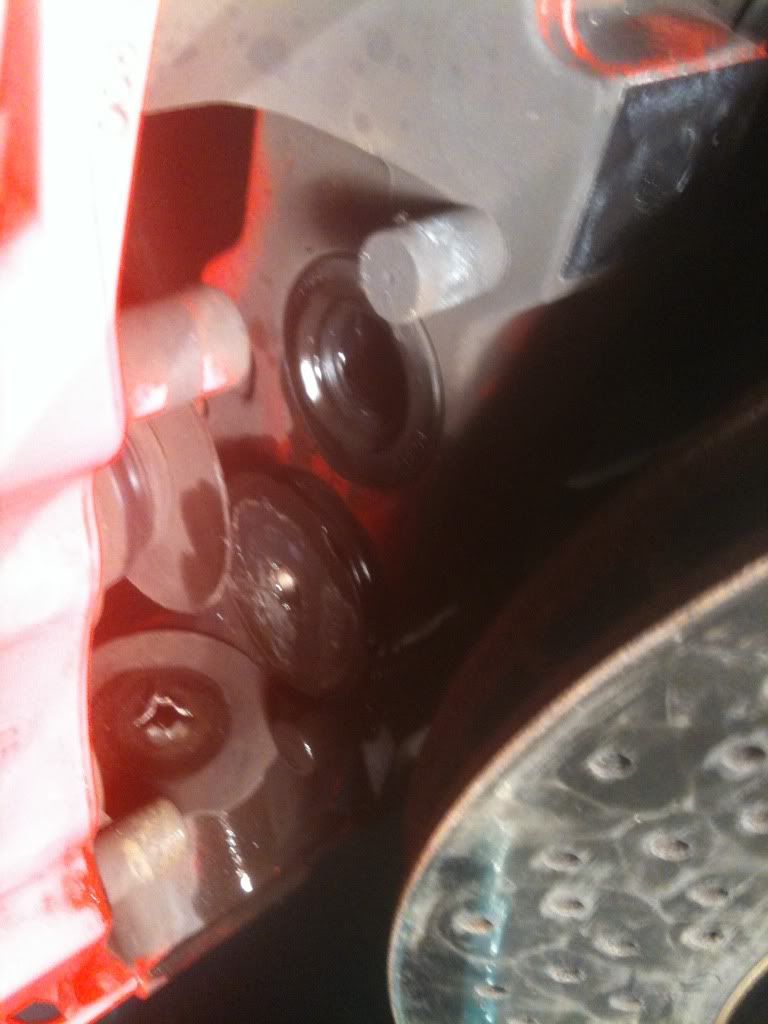

The brake piston on my left rear caliper came completely out and now brake fluid is leaking everywhere. (being caught in a container now). I've tried to put the piston back in the lower right section of the caliper but it's not working. Please help. What should I do? I'm freaking out. :eek:
Piston that came out:
Another shot:

1. I need to replace BOTH rear calipers because the rear left was damaged. They said that you cannot just replace one, you need to replace both because they work in conjuntion with one another. Huhhh????
They said the damage was due to all the dust seals on the rear left caliper were broken. Incorrect. I inspected the caliper myself and only the rubber boot which the piston popped out of is torn.
Does this make any sense!?! Replace both of the calipers?? Sounds like a bunch of hot air to me to get some extra $$$.
I plan on getting the caliper repair kit and simply installing a new rubber dust seal.
Putting the piston back in was actually very easy. I just took the rubber seal out of the caliper, put it on the piston, then re-inserted the two as one piece back in the caliper.

Humm, the more I look at the photo, I doubt it is the damper pad. My guess now is that the excess travel of the piston without a pad in place tore the rubber gasket in the caliper.

Are you sure that isn't just the brake damper pad?
Front Brake Pad Damper:Suncoast Automotive Porsche, Audi, & VW
The "pistons" in our brakes are hollow.
Now the leaking fluid is a whole other issue. Where is it seeping out of, the piston surround?
The brake fluid I presume (clear-ish fluid) is coming out of the hole where the caliper piston came out. The more I'm thinking about this the more I'm realizing I'm going to need a new caliper. At least it's the rear (smaller), so it will be cheaper... That is about the only light I can bring out of this situation. Somebody start throwing brake caliper prices at me :wall:

Normally the pistons when unostructed just come up to the lip, however a little more pressure behind them and they will pop out. I would think that there should be a caliper repair kit and couldn't imagine a new caliper is required....of course I could be wrong, but the cosntruction is relatively simple so can't imagine Porsche don't recommend repairing them.
A seal kit may be all you need, but maybe not even that. It will need some pressure but should go back in IMO.

I don't think you will need to replace the entire caliper. I can't see clearly enough, but the picture could be the piston with the damper still installed and the first picture looks to me like an empty dust cover. Attached is a picture of a representative Brembo piston replacement kit so you can see the components. If you have pushed the piston out past the seal, then major leaking as described will happen.

If you need to move the pistons out, remove the brake line and connect compressed air. You need to be VERY carefull with the application of the air, (and keep your fingers out of the way - just in case) but you'll be able to see and control with this method as opposed to being blind with the brake pedal method.
Getting the piston back in is a neat trick, just get a new calpier and chalk this event up as a learning experience.

I've taken the pistons out of a couple of calipers in the past. I had to put a set back in at the track once due to an overly helpul friend while changing the pads and bleading the brakes. First clean the area with brake cleaner. You do NOT want any dirt in the bore. Rebuild kits are available for most calipers. The trick to getting the piston back in is making sure the piston is normal to the caliper body. As you insert the piston use a slight rotation of the piston as you guide it in. Don't force it in. The piston should be lubed either with fluid or the rebuild kit may have a small lube packet with the new O rings and dust boots.
A note on removing pistons with an air gun: put a small piece of a 2x4 or 1x4 cut to a size to fit the caliper and let the piston hit the soft wood. You don't want to let it hit the other side of the caliper.

You're onthe right track - just replace/re-use this piston via a seal kit. If the tech is qualified and careful, it'll be good as new. This happens sometimes on race cars, if the driver touches the pedal during a pad change sometimes pistons are flying around like hot potatoes. Not what you want to happen during a race. You do Not need a new caliper.

This happned to me once on a domestic. I was afraid that I tore the seal but that was not the case. I used a "C" clamp to slowly drive the piston back into the cyclinder.
As already mentioned you need to follow-up with at least a bleed if not a complete flush (recommended) as your hygroscopic brake fluid has been ingesting moisture the entire time it has been exposed to air.
