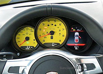

You can always Google Suncoast parts and order a white on black tach (which ironically comes on the standard non-S model), or get a tach or both the tach and speedo in matching colors. White on red, black on white and black on yellow are also popular, and you could either swap them out yourself or have your friendly neighborhood dealer (for a price) do it.

Anyone here ever do the swap? I imagine that getting the instrument cluster out is not the hard part.

I went through the exact same thought process as @MLCayman!! My Infiniti that cost half as much as the Porsche did a better job of lighting up the gauges!!! I have tried to find somebody to reprogram the ECU with no luck. One of the problems is that they put a light grey lettering on a dark grey background (another wonderful idea). Not sure how this one got past any sort of engineering review/approval. It's not like one person approved this because it carried over to the 718's as well. The 718 GTS has a black background that helps with the contrast. I have found replacement face plates from SunCoast parts but can't find anyone to replace it because if you break the clip that holds the tach needle then you have to replace the entire instrument pod for thousands of dollars. I'm not sure what the background is on the 981 GTS but it may be possible to source one of those and use it as a replacement.

Yes. You have to turn SOME lights on and then there is a hint of light during the day. I am exploring changing the faces on the dials. I imagine it will cost $1000 or so. A frustrating unnecessary expense. There should be a safety-related class-action law suit started.
