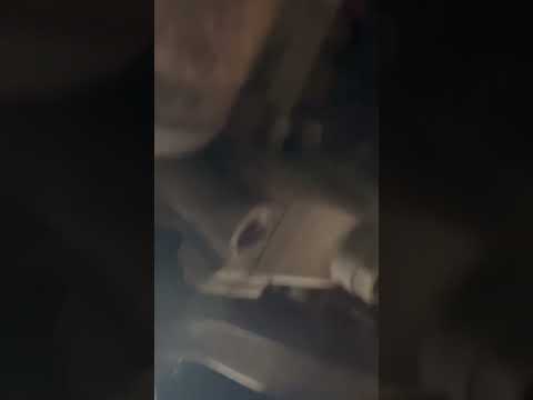

Hey all, I started up my 08 Cayman S today to a lot of vibration while it was warming up. It felt like someone was bumping the car. Rpms weren’t jumping crazy or anything, but the feeling was way more than usual. It leveled off and smoothed out after about 30s. I did notice a tapping noise when I walked around the car on the passengers side at idle. I’m doing some touch up work, and haven’t driven it in about 2 weeks.
Here’s a video of it at idle. It’s still not up to temp.

The tapping noise is pretty normal after sitting. Drive it around a little and make another video… not sure about the rough idle, I’m not hearing that tho.

Thanks! Yea I’ll have to get it out after painting. The engine was already replaced for bore scoring in 2014, so it would be crazy for it to happen again right?!

I was just a little freaked out because it sounds eerily like this.
Doesn't sound at all the same to me. You have a light tap.. perhaps a noisy injector or a lifter that hasn't fully pumped up. This video has a bad sound.. something is wrong with it that isn't simple or cheap.

Agree, injector or probably a lifter that’s at idle oil thirsty…drive it’ll go away…
If you had bore scoring, the exhaust and rear bumper cover would probably be all soot covered.. oil consumption would be the next issue… check the oil and drive it and then look at the few items mentioned.
These motors are great but they can really $uck…. Rule of thumb, don’t let them idle. Soon as the high idle drops, drive it (normally). There isn’t full capacity oil being pressured into the motor at idle, flat 6’s do not like that…the government does!
