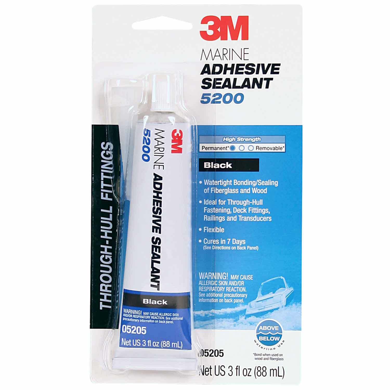

I'll have to look into buying some of that from a reputable seller. I had a feeling that the Home Depot 3M 2x-sided tape wasn't this strong, and the stuff I ordered on Amazon was likely counterfeit.
I'm also considering (as a safety net) somehow also adhering a very small thread of fishing line as an emergency backup safety measure, as ideally it would remain hidden inside the scoop. This way, if it falls off at speed, at least it won't disappear. Yes, it might damage the paint but I doubt it. That has worked really well for side panels on my BMW R1200C motorcycle, and a lot of us do that retaining cord given a similar problem.
That's a good idea. You maybe able to epoxy the line to the back of the grill on the black part and tie it to a hook or a screw on the inside panel of the scoop.
