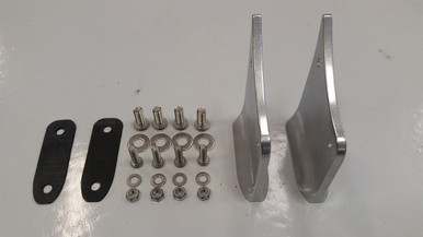

Spoiler Hardware - The factory spoiler contains a number of specilized hardware pieces for installation. And of course, many of them are discontinued. I worked with Suncoast and was able to source the following parts to the tune of $850 (Ouch!). The biggest challenge here for installation is the driling templates are no longer available. Most of the other unavailable parts are fasteners and weather stripping. I have a good body guy that was able to figure it all out and make it work.
266253
I attached the aerokit instruction manual which has all of the relevant part numbers and such.

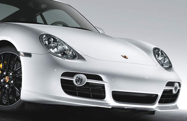

Front Splitters
The front splitters are much easier to source as they are still made by both Porsche and GT-Racing. They mount just like the stock ones do.
GT-Racing - Factory Replicas, this is the option I went with, mainly because they were half the price of the factory option.
Porsche

Thanks! It’s a 987.1 but the rear should be exactly the same for a .2. Yep the Fredle package comes with the spoiler and the blank. The blank attaches with the hardware from Porsche. Its a pretty specialized piece so would be hard to fabricate it. You remove the stock spoiler assembly entirely, motor and all. You then have to set the car to “Fixed Spoiler” in durametric or via the dealership.

357 Posts
The smile vent is to give airflow a direct exit. 987 with a 3rd radiator usually vents the air downward while GT cars have the vent going upwards.
PCA Nat'l DE Instructor
1,841 Posts
Am I right to assume the smile vent is for better cooling as well for the front radiator?
On the 987, the third radiator kit vents downwards through cutouts in the front bumper cover. Adding a GT3 smile vent on a 987 is a purely aesthetic modification.

Why did you need the spoiler hardware/drilling template? Would you not able to just attach the spoiler with body glue?
