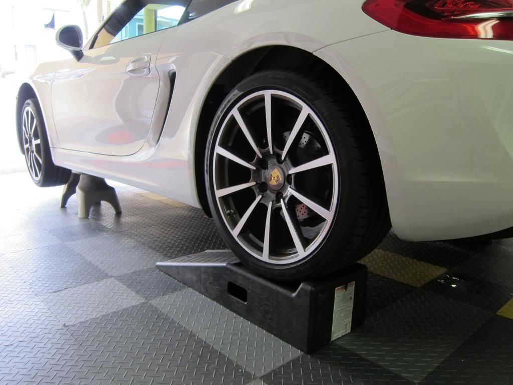

I used rhino ramps and backed the rear tires up on them. They're about 9" tall but then you add the tire and you end up with a descent amount of space. I was able to use a crawler for the whole project I believe. Hope it helps. The height at the rear bumper was around 2 feet? Should of taken pictures of the car on the ramps.:(
Can you get all the oil out using ramps? Doesn't the car need to be level?
On my old 997 I used Rhino Ramps on the rear and Jack Point Stands on the front for the reason you mentioned. It positions the car level and allows for my ole sorry a*s body to crawl underneath safely.
I'll be doing my 1st oil/filter change on my 3 month old 981CS next week using the same technique. I take some photos and post them when I'm done.

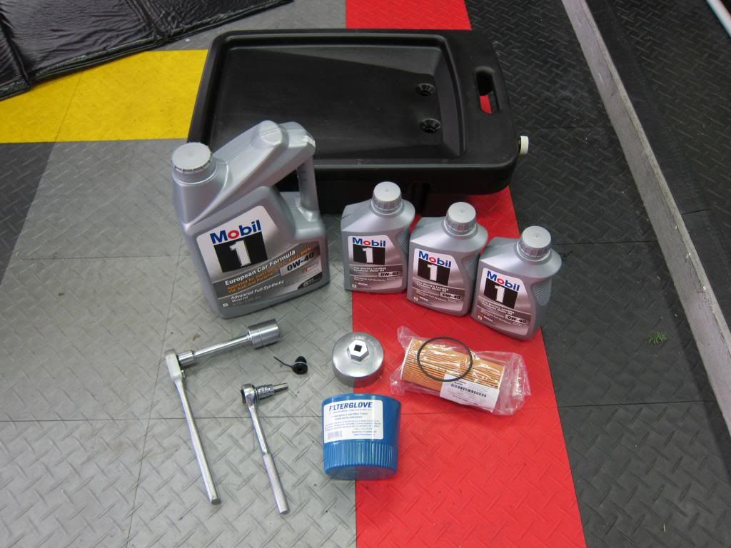

Here's the photo's I promised. Replaced the drain plug w/ the LN Engineering magnetic version.
Did all 8 quarts fit?
Those are interesting jack stands up front, who makes them, do you have a picture of the top where the car rests? Cost and where you can get them?
Filter glove, what's that?

Those are jackpoint jack stands, very nice and easy to get the car up and onto stands. http://www.jackpointjackstands.com/
The raise the car on the jacking point and have pin in the center. They also have a pad with a slot that's for unibody jack point type cars.

The filter glove is used to hold the filter canister when your removing it to avoid spilling oil. However, there is no room for it's use on a 981CS since the filter canister is in a confining area. I used it on my old 997 and thought I would do the same on the new 981CS but it didn't fit.
8 quarts is a proper fill when changing oil and filter. The green 'Oil Check' bar is one down indicating a full oil sump.
