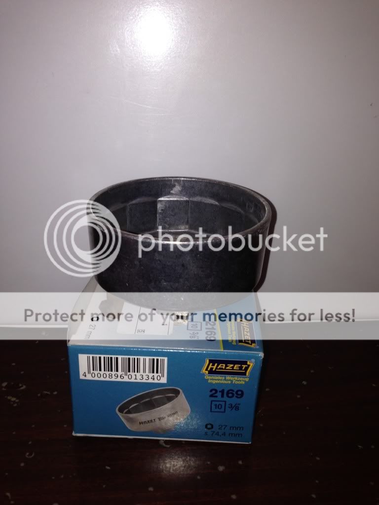

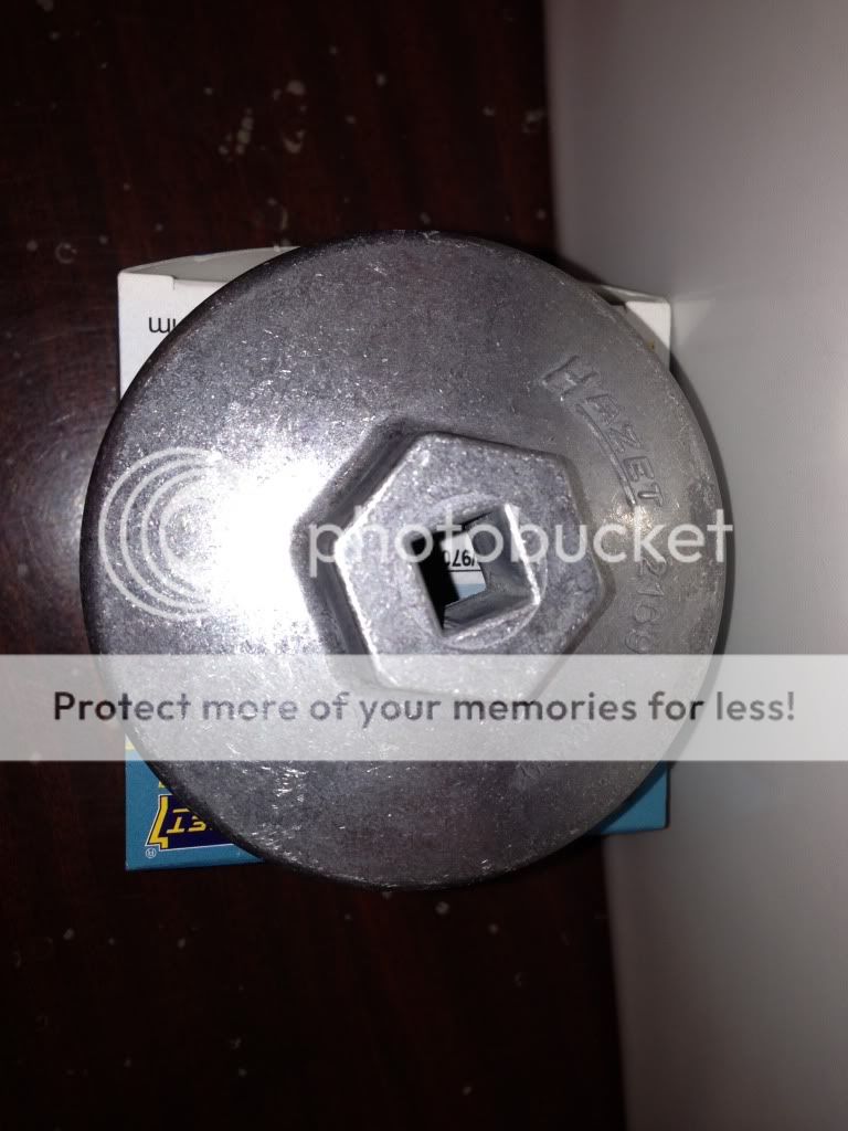

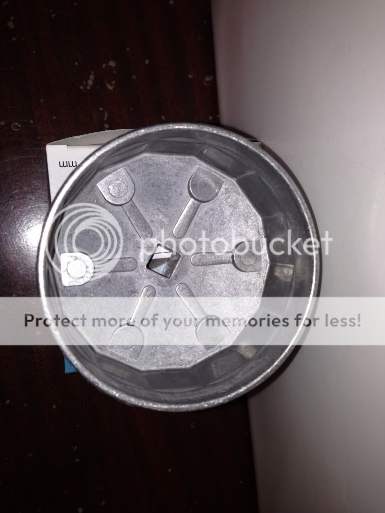

i am getting a bunch of hazet 2169 in stock! 74.4mm
I am gonna sell em for 29.99 each. + shipping... shipping through lower 48 should be 9.50 through usps flat rate box. if i can fit in the box...i will get my first 10 today...
i will post pictures this PM..
thanks
lemon
special socket for the porsche oil filter cover remover.. by a trusted german tool company....not the pepboy's stuff if you can find the special size..

hi guys as promised....
29.99 + shipping..
